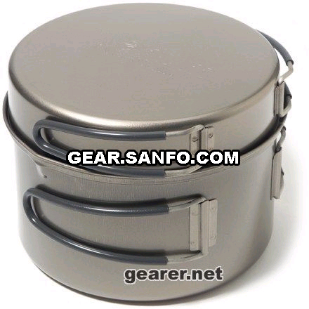

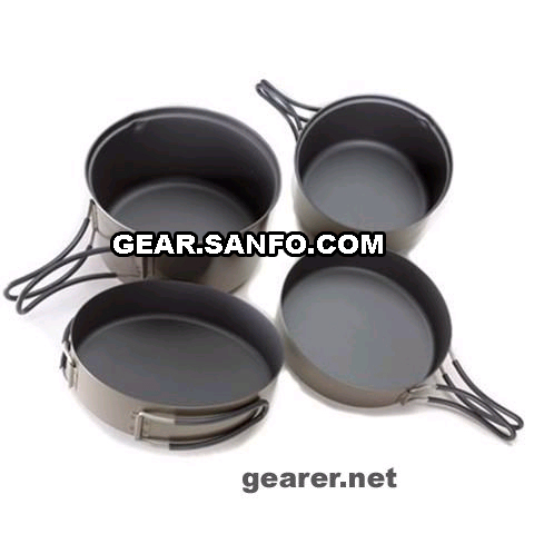

我们看看这个4件套的指标和图片:
Lighter than steel and stronger than aluminum, corrosion-resistant, chemically non-reactive titanium conducts heat efficiently
Extra-thick silicon ceramic coating is superior, passing tests for heat, corrosion, frying and scratch-resistant hardness
Rounded bottom edges offer more surface area to the flame and are easier to clean
All pots and lids have folding wire handles that allow the pots to nest; insulative coating on handles improves grip and prevents burns
Lids double as fry pans
Nylon storage sack with drawstring included
1.9 liter pot = 3.75 inches (height) x 6.75 inches (diameter)
0.8 liter fry pan/lid = 1.75 inches (height) x 6.75 inches (diameter)
1.3 liter pot = 3.5 inches (height) x 6.25 inches (diameter)
0.7 liter fry pan/lid = 1.75 inches (height) x 6.25 inches (diameter)
Weight 1 lb. 2 oz.
实际上这个套装是Evernew的钛不粘套装中的3DX和4DX两个型号,还有一个更小的2DX,可以单独购买。

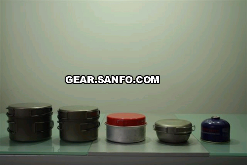

从左到右:
Evernew大锅、小锅、LAKEN铝锅、SP钛3件套、气罐

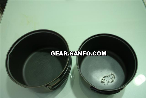

或许大家说这个锅不适合中式烹饪。那么,这次我去后河,做了一次意大利面以后的下场如何呢?
大锅用来煮面,仅仅是简单的搅动,做完饭后用湿巾把锅擦干净,在锅底就留下了千疮百孔的划痕。
而煎锅呢?仅仅用来热了一下我提前做好的意粉酱,在锅底就留下了难以去除的一些黑色斑点。
实际看看糊迹和划痕
我试着用SP的小勺轻轻的(注意,真的是轻轻的,应当比正常吃饭做菜的力度小多了)在锅底划了一下,一道明显的痕迹。
